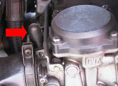

Die Schotten selbst haben mir folgendes geschrieben und als Anhang geschickt:
"It should be possible to install our vSystem to your GPZ but as it is 24 years old, we don’t have any photos. We know that the front of the carburettors have brass nipples with rubber caps that you can remove and push on the vacuum damper from the kit (see photo).
Because the swing arm has eccentric cam chain adjusters, you will need our “Chain guard adapter. The only thing we don’t know is how much space there is for the reservoir."
